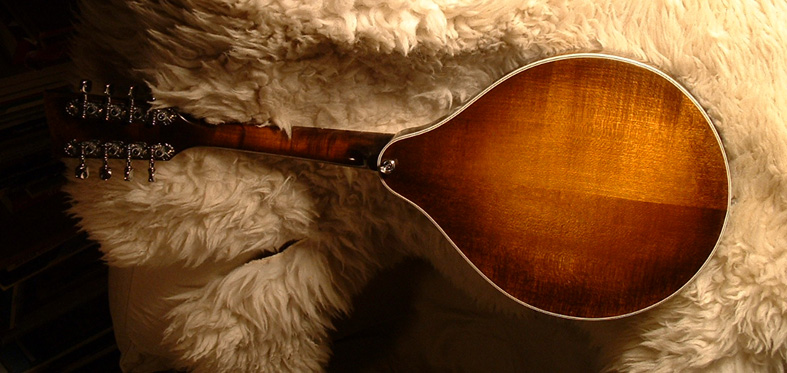

Another way to do it is to rub dyes into the bare wood, then finish. This gives a bit different look that the sprayed one. If not done right it can look splotchy, but done well I think it gives a more subtle, interesting soft 'burst. I use liquid aniline dyes mixed with alcohol. The way I do it is to first rub vintage amber over the whole instrument, then medium brown around the edges, and last tobacco brown or dark brown on the very edges and corners. You can use alcohol to wipe the whole surface to blend the colors and take some of them off, but not too much or you can get uncolored spots, runs and all kinds or trouble. The dyes will soak up more in endgrain than elsewhere, which helps to pop the figure. Here's a mando I did a couple of years ago:

All interesting stuff. Arnt, that looks really nice. I really want a *subtle* burst, and I plan to keep it very light. I know that Kim Walker hand-applies his bursts similar to that. I think they are really nice. My object is to not hide the grain with a very dark edge, but keep the grain popping through. Why hide all that flame? I'll be binding in ivoroid, so it sounds like I should seal it all, then spray or rub on the colors, and then scrape the bindings afterward, right?

If you rub, don't seal at all, just wipe the colors on the bare wood and let it be absorbed. Like I said, this helps to enhance the figure.
